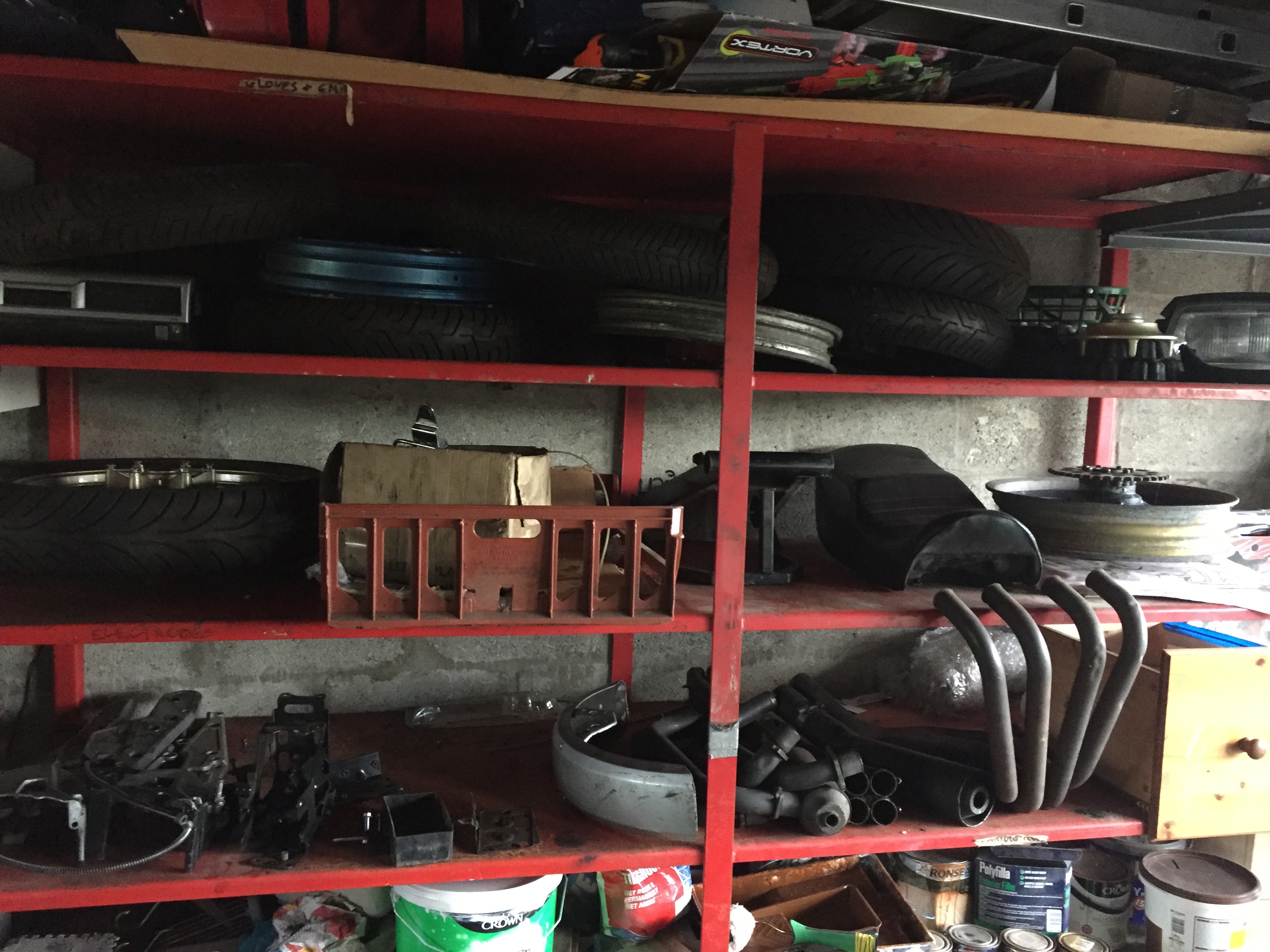

So, I proceeded to empty all the boxes & try to get some sort of order, to see just exactly what I have here...
The plan is to dry build it, then strip & send the various parts to paint , powder & polish.
I got to this stage today ....
What I do need to start with is...
* Clock assembly with a key
*Nose fairing & screen
* Starter motor
* a side stand bracket
I'm slowly getting through all the boxes & should have all emptied & on the shelf by tomorrow.

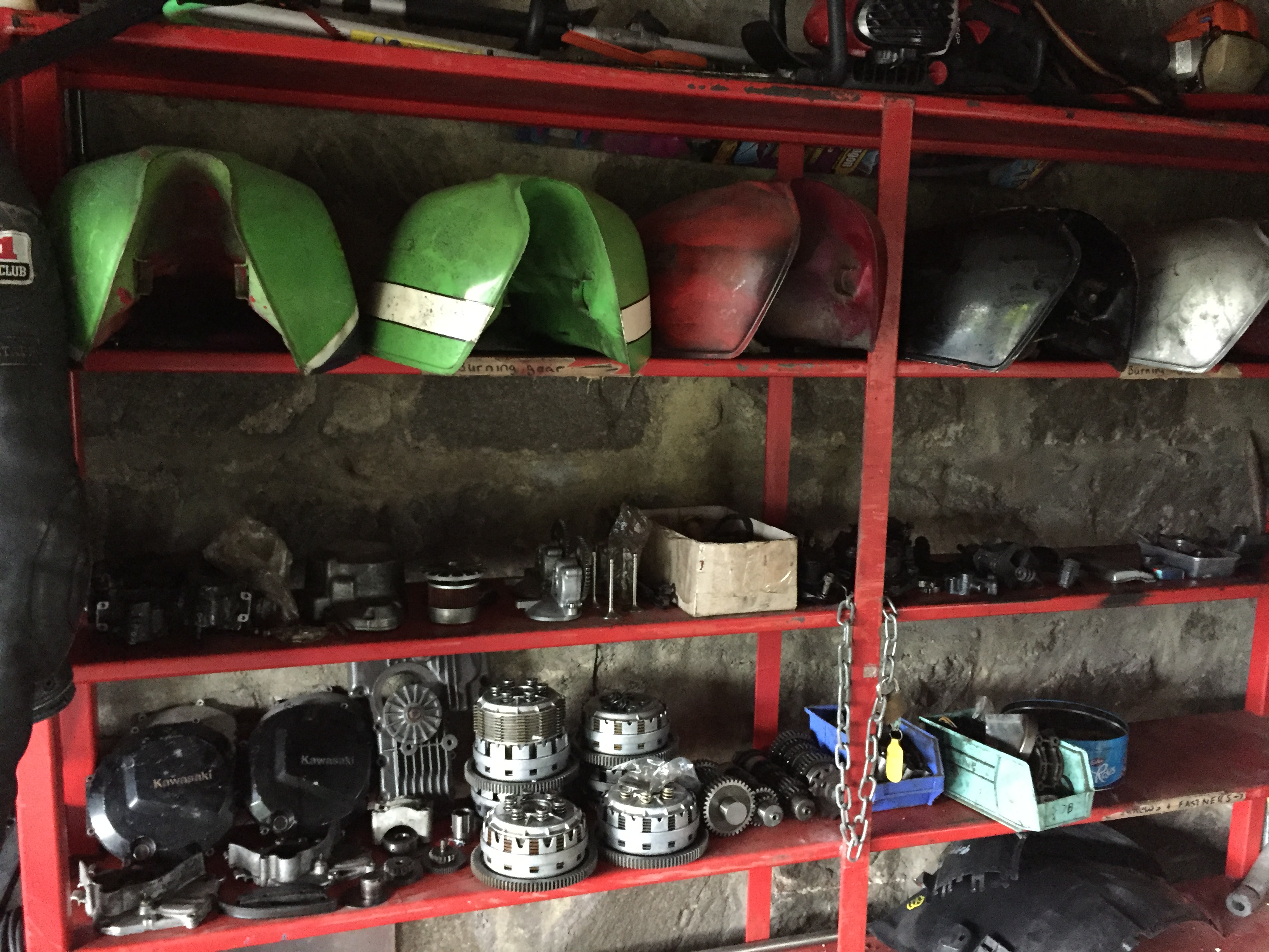

There seems to be lots of GPZ parts.
Also multiple brake discs, mostly all very good.
Multiple Clutches, Dyna S ignition plates, a scruffy kerker
A scruffy Harris, A pretty good V&H.
Some members have asked about parts, I will get back you guys via PM

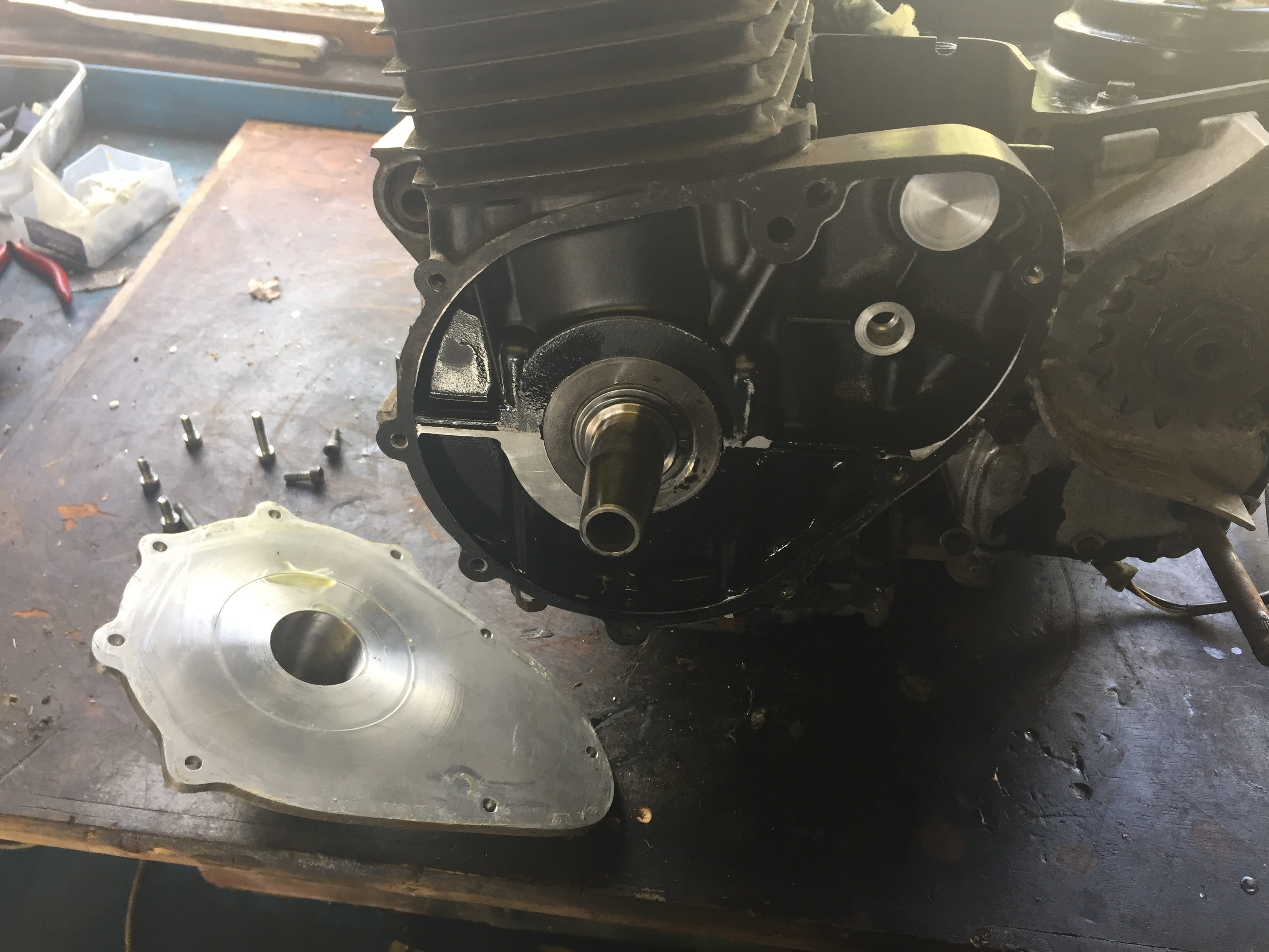

Doing a bit more today.

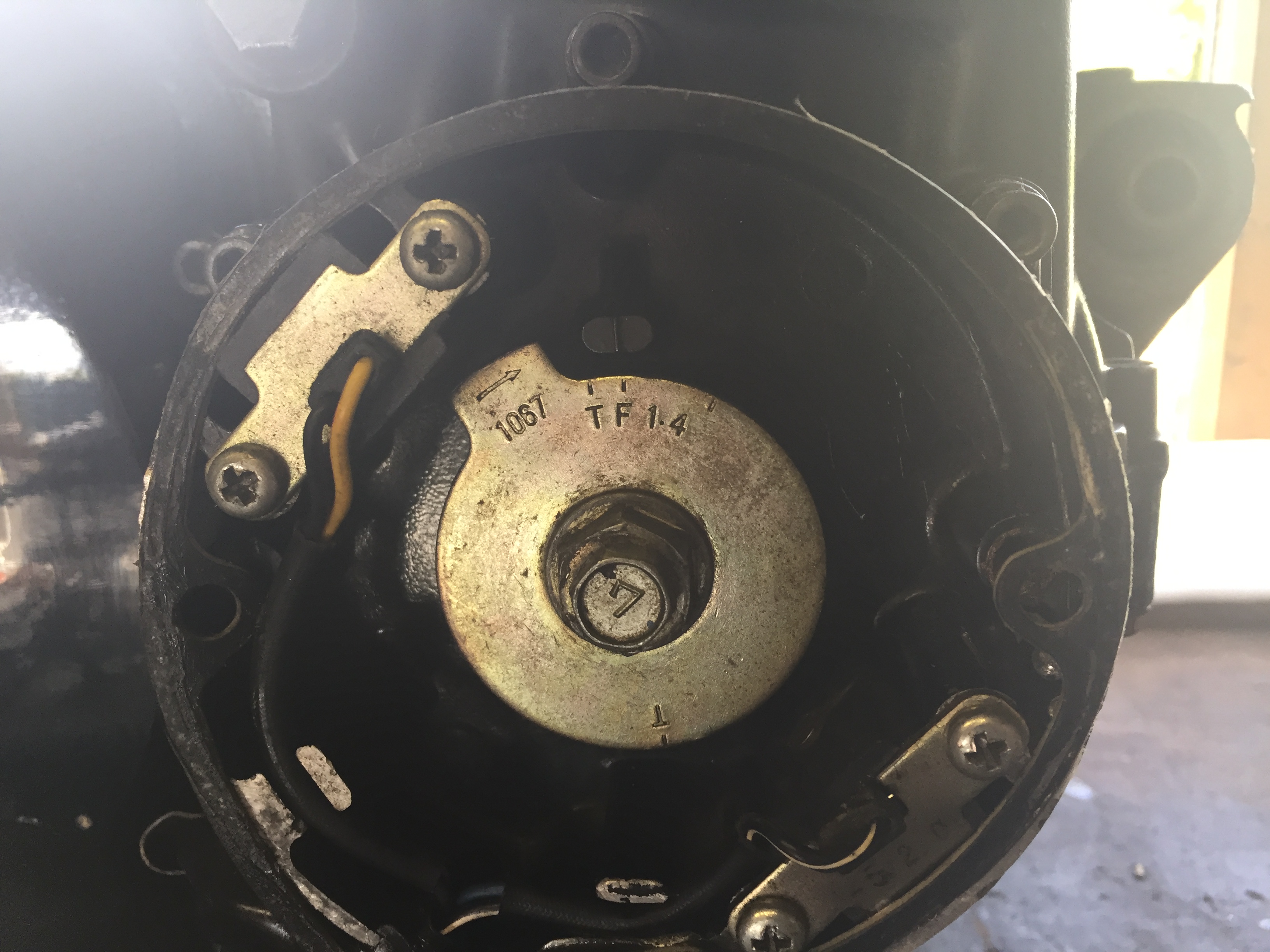

Checked out the ignition, I have not seen one like this
Can anyone enlighten me?
What type of ignition is this . ??
Also removed the race alternator cover.
So I will need a starter gear assy & a rotor.
Are the rotors all the same on these ??
Rotor & starter gear assy Required

#12 PostAuthor: Gus » Mon Jul 10, 2017 2:10 pm
Looks like GPZ1100 Unitrak to me if it's connected to the Igniter it is probably in a plastic case
Looks like a unitrac output shaft so may be a whole unitrac motor See what the engine number is.

#13 PostAuthor: Julian_Boolean » Mon Jul 10, 2017 2:39 pm
Z1100R has a Unitrak engine, that ignition pickup is standard Unitrak, if you want to fit a Dyna ignition you'll need a J engine casing
