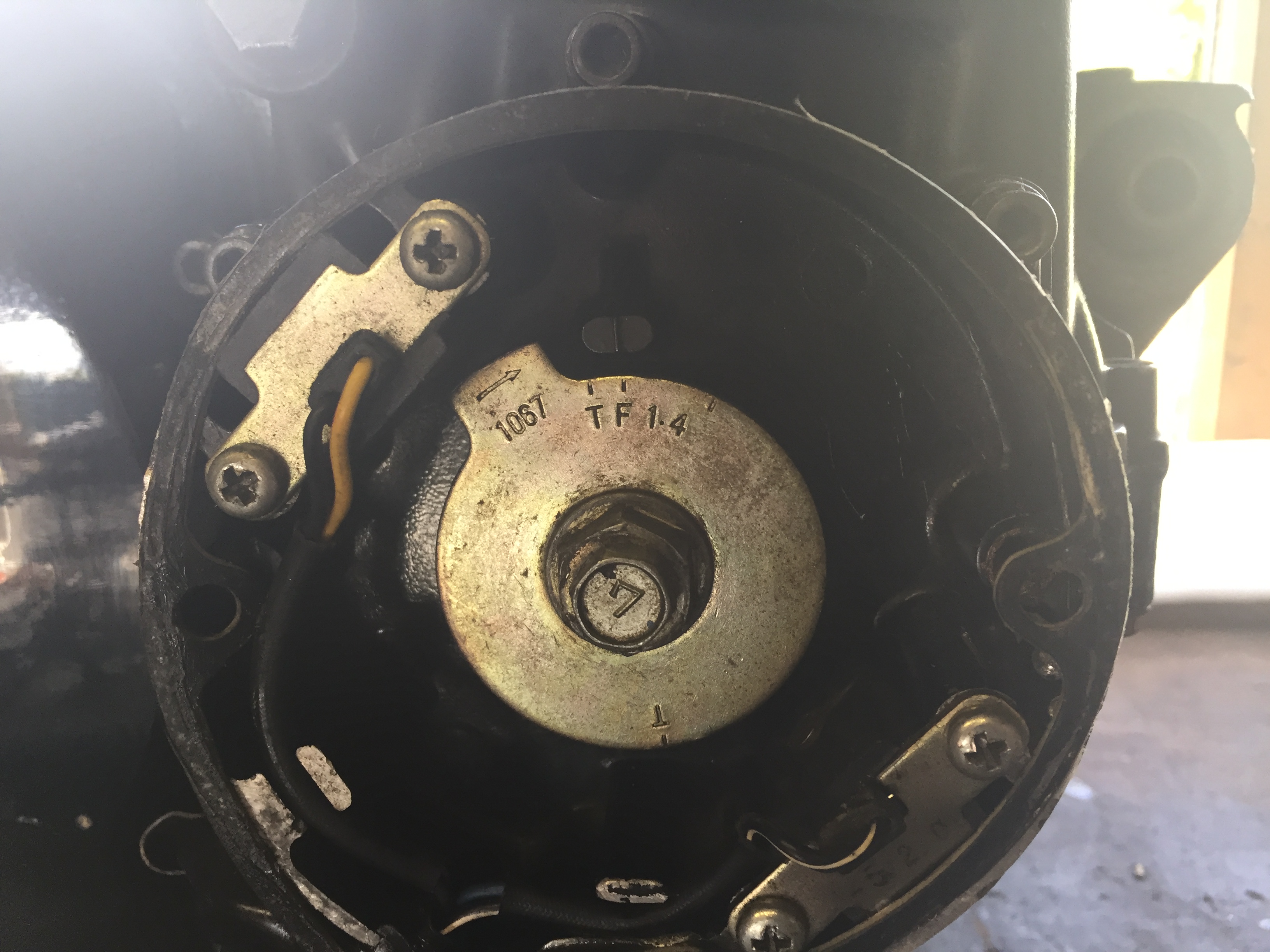

#11 PostAuthor: z1000puddin » Mon Jul 10, 2017 2:07 pm
Doing a bit more today.
Checked out the ignition, I have not seen one like this
Can anyone enlighten me?
What type of ignition is this . ??
Also removed the race alternator cover.
So I will need a starter gear assy & a rotor.
Are the rotors all the same on these ??
Rotor & starter gear assy Required
Anyone have one they want to part with?
Stu

#12 PostAuthor: Gus » Mon Jul 10, 2017 2:10 pm
Looks like GPZ1100 Unitrak to me if it's connected to the Igniter it is probably in a plastic case
Looks like a unitrac output shaft so may be a whole unitrac motor See what the engine number is.

#13 PostAuthor: Julian_Boolean » Mon Jul 10, 2017 2:39 pm
Z1100R has a Unitrak engine, that ignition pickup is standard Unitrak, if you want to fit a Dyna ignition you'll need a J engine casing

#14 PostAuthor: Gus » Mon Jul 10, 2017 3:01 pm
Doh!
Course it does, brain fart
